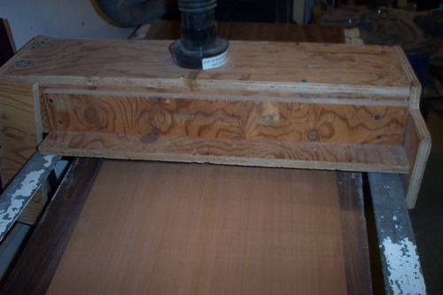

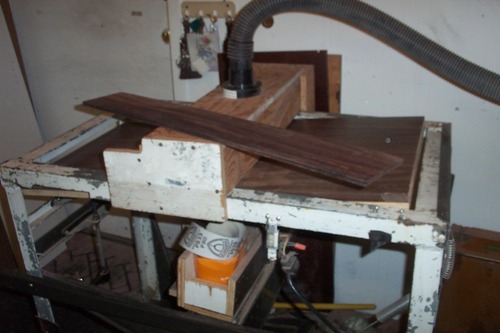

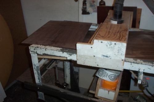

Might as well sand them all down i guess, so yeah, 2 guitars, 3 mandos, there might be 2 ukes along the way, could it be that giant box of Corn Flakes that does this to me?

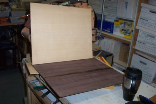

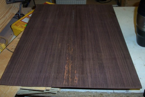

Here are the joined top and back ready to be sanded

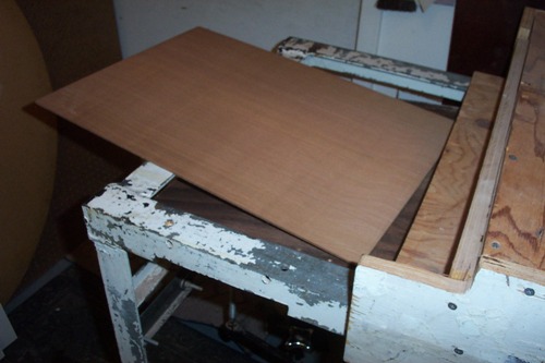

Here's the joined red cdar top that Shane gave me when he came here, about to go inside my beast! This top will go on no 3. Thanks Shane!

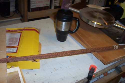

here are the snakewood bindings that will go on no 4, isn't that gorgeous or whut? Thanks Papa zoot Bob!

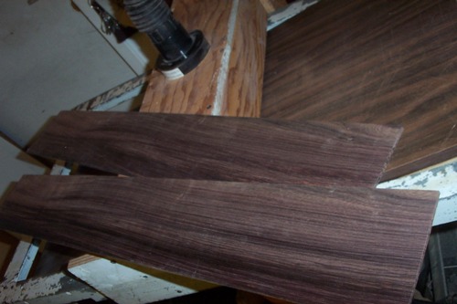

The EIR back about to go in as well, it's got nice figure and little streaks of lighter color, very nice!
The sides

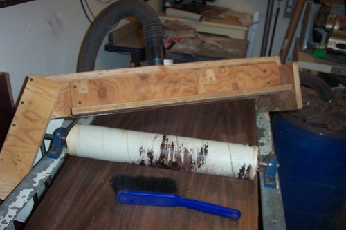

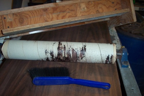

My drum sander has worked very hard today, The EIR clogged the sand paper, time for a little break from sanding me thinks!
Thanks again for watching

I think you missed a pic, though. You mention snakewood bindings?

On your sandpaper clogging, I recently got an abrasive belt cleaner, that really extends the life of your sandpaper.

Thanks Al, i just edited! Yeah, i think i just got in to debt more but also more fun!

One thing you will want to make sure of is to NOT bring the cedar down as much as spruce, you will need to keep it around 0.125-0.135 or more, depending on the stiffness, just try flexing it and than a joined spruce top, you want them to feel the same, but the cedar should be much thicker to feel as stiff as spruce.

[quote]On your sandpaper clogging, I recently got an abrasive belt cleaner, that really extends the life of your sandpaper. [/quote]
   I use one, love it! It helps to use it when the papers hot and not let it build so bad. Don't let your dog see it though! He does bad things to it!
   Looks like you have some runout on your sanding drum! If you glue some sandpaper on a board and pass it through, without paper on the drum, it might take care of that. That would make your paper last also!

PostPosted: Sun Aug 20, 2006 1:53 am
Those snakewood bindings are very beautiful. A great idea to have subtle bling* (see below) appointments, with spruce and rosewood. Great combo.

Thanks Rod, i wish i had known that prior to sanding, now the cedar is down to 0.105, what should i do with this???? Do i make taller braces for it??? I should have asked my bros.

Thanks Sam! I love that word for describing beauty of the wood, i think this rosewood guitar will be "Blingalicious" indeed! Now we have a word for each side of the pond, we will have to ask the Aussie folks to come up with one from the down under!

Rich, are all abrasive belt cleaners created equal or is there a significant difference? I have used some purchased from Sars and also from Harbor Fright and see little difference. In fact, while they do an ok job cleaning soft wood like Spruce, when I get the drum loaded up with those resins from the rosewood they dont even touch it. Never comes really clean and looking for a sure fire way of some approach other than throwing away this very expensive drum roll paper.

Good question there Rich, i bought my roll at Lee Valley's(where else do i shop? )and they are quite expensive but i think they are worth it, the result that you see was due to my lack of patience towards the end and i took stronger passes, i'm wondering if i would have had the same clogging result if i would have made lighter passes....

Well Serge as far as the cedar goes, I don't know, that is preaty thin. I would ask the more experienced members here, John Mayes, Sylvan, Kevin G, Howard K (I'm sure there are others also) these guys have a ton (250 plus I'm sure) of builds under there belt and I bet they would know what to do.
